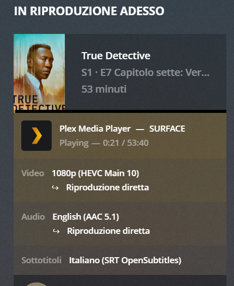

Hi! I have this strange issue that when a video is played remotely it will be transcoded, but the same video will direct play if played localy (same server, same client, same settings).

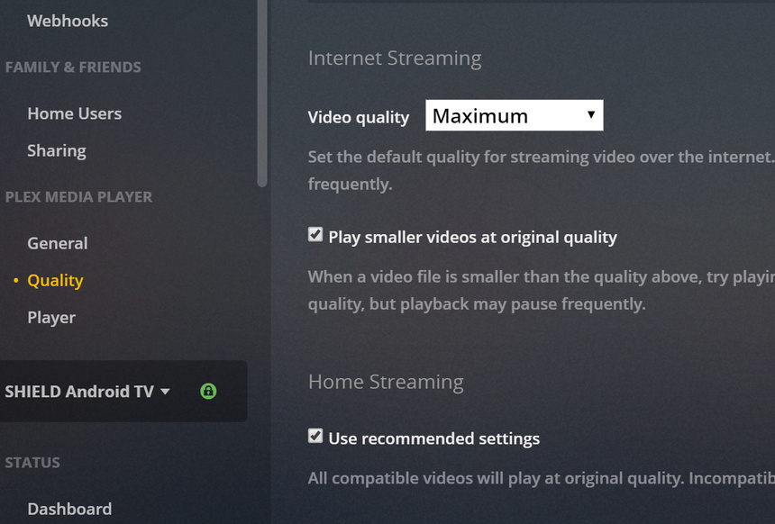

Your logs say that you have the client set with a remote quality of 2 Mbps.
Feb 19, 2019 14:35:00.791 [10747] DEBUG - Streaming Resource: Calculated bandwidth of 45636kbps exceeds bandwidth limit. Changing decision parameters provided by client to fit bandwidth limit of 2000kbps

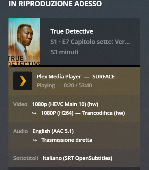

The video started in 720p 2mbps but I manually set it to “original” shortly after. You can see in the screenshot that it was playing in 1080p but it was transcoding from HEVC to H264.
However, I just changed this setting and tried again and same result only this time the video started directly in “original”.
Scroll up a bit. Do you have the option enabled for “Automatically adjust quality (Beta)”. If so, then if a video starts out transcoded, it will always stay transcoded.
That option is not present in PMP even if I select “show advanced” but I can see it using the web browser and it’s not enabled.

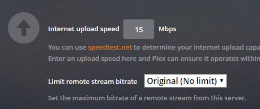

you should also have your server upload speed set according to your server internet upload bandwidth.
https://app.plex.tv/desktop > settings > remote access > internet upload speed & limit remote stream bitrate speeds

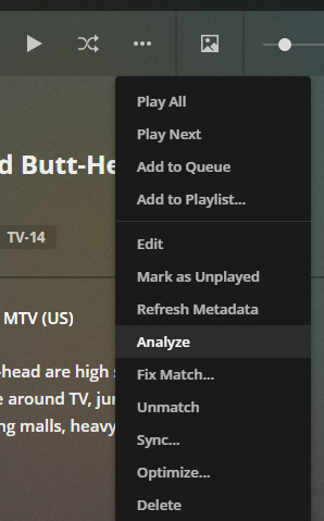

perhaps try reanalyze that series?
from plex web navigate to the series
https://app.plex.tv/desktop > series > 3 dots menu
That didn’t work. However, this is not a problem anymore since I can solve the problem by simply renaming all the files. The question is: why did this happen?
