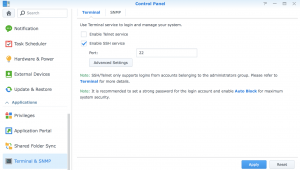

  2. You need to log into the ssh terminal for this (Control panel - terminal & snmp)
  3. Log in as “admin” (set a password you know for “admin”)

@Makasima I saw that, but I’m not sure how to connect via ssh. Can you provide a little more context? (I am a noob and I don’t want to screw things up.)
Also, when it says log in as “admin”, does it have to be actual admin user (which is currently disabled), or anyone with admin privileges?
Thanks again…
You can read this:
