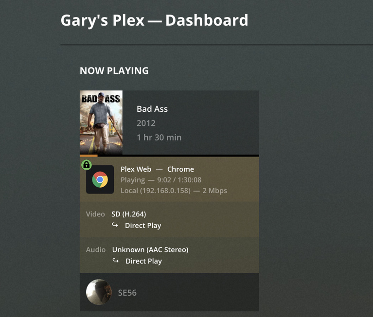

When playing on the LG with a 4K title can you go to the server/ dashboard and take a screenshot,
like sample below.

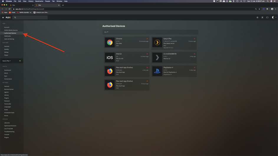

I dont see a devices section in my settings?
think I found the server version below.
Server Version:1.18.4.2171

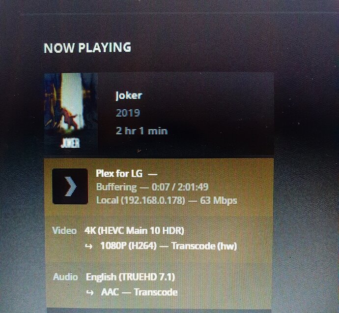

I have tried it on wifi and LAN cable and neither have worked. I also went into the DLNA app on the TV to play the file directly and the tv didn’t recognise the file type. It did start to play it on plex but buffers after two seconds.
The TV is LG49UB850V
Ok, a 2014 TV so Player is on WebOS 1.4 player version : 3.13.27
As you can see with your Joker Title, it’s trans coding Audio and Video, that the issue.
If you wish to change this behavior, you would need a non Hevc and no True HD 7.1 audio file.
Now considering your TV is now about 6 years old and LG app is no longer supported, there are few options.
