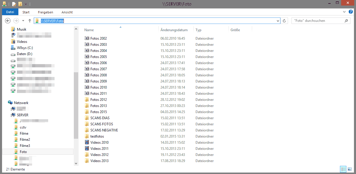

Can’t seem to insert an image so I’ve attached them. First is explorer showing the path. The second image is Plex add library window. The NEXT button does not enable so I’m assuming it doesn’t like the path.
And no, I don’t have the same Windows and Synology logins. I’ve tried setting the login during mapping to the Windows user but that doesn’t stick.
I think I figured out the problem. I’ve mapped Y: to \\mg_diskstation\music. In those folder are individual folders that contain the artist\albums folders. Pointing to the Y: drive, I’m still unable to continue. However, when I select one of the individual artist folders NEXT is available. So it looks like I need to reorganize as it doesn’t like selecting the root folder. So now I’m not sure what will be the easiest way to go.
