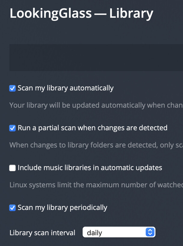

I did update to 1.25.0.5246 just a bit ago and after @Blkbyrd suggested it I flipped the automatic detection and scan settings off and back on again (it was on and working most of the time - unless I’m looking at the wrong setting).
I did restart Plex per your suggestion and here are the logs after waiting a couple minutes. I don’t recall if I updated Plex today before or after flipping the automatic scan checkboxes off and back on again (fiddling between other tasks).
Plex Media Server Logs_2021-11-16_15-18-51.zip (3.3 MB)
Edit: Pretty sure the timing was I updated to x.5246, turned the Scan Auto\Run Partial off and then back on. Few minute later saw ChuckPa response and then verified checkboxes were still enabled. Restarted Plex. Grabbed new logs.

Thanks @ChuckPa I appreciate you taking a look for me on such a small issue. Something between the Plex and Synology updates recently must have thrown that off a bit as the checkmarks for that were definitely still enabled and the problem persisted randomly even after the previous Plex package update so something wasn’t making the translation. I’m glad it was a simple fix. It might have been @Blkbyrd suggestion of flipping the checkboxes off and back on that finally triggered it.
