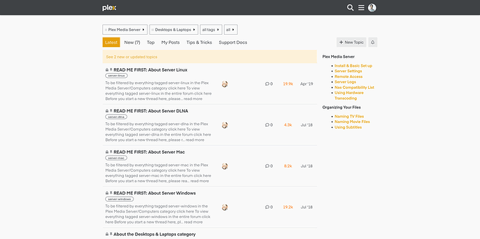

besides the info given above there are links to claiming and trouble shooting claiming in the link in the banner at top of forum

I don’t believe I’m seeing the links in any banner that you’re referring to. I see quite a few posts that seem similar and have a variety of things to try for specific installations. I’ll try searching for reclaim and read through some more posts and see if I can find anything that helps me.

Hey, not sure why are you not seeing the banner but I just pinned the info as the top post in home page…

I think if you have previously click the X (close) on the banner. You won’t see it again (only in incognito mode).
