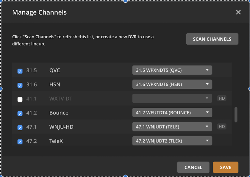

I am having and issue with my channel guide for the live TV feature. I am using and HD HomeRun Connect. Through their app I am able to get 44 Channels. The Plex guide only shows 42 Channels. I only care about one of the missing channels. I currently reside in Brooklyn , NY. I am missing Channel 41.1 WXTV-DT Univision. I am able to see the channel with good signal strength the the HomeRun App. I deleted my DVR and recreated it and did notice that it was unchecked. So i selected the channel and noticed that the description side there was not channel mapping found for 41.1. Is there anything that I can do?

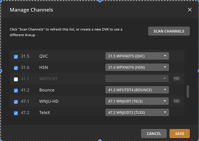

This is what I see, when i check it the channel description is not listed.
Once you Check it there is nothing in the drop down menu to the right?
If nothing populates for channel 41.1 try re-scanning for channels. It’s obviously receiving it just fine if you can view via the HomeRun app. It’s even marked as HD in the image you included. Try checking the channel and then manually selecting 41.1 from the drop down and include an image of that.
