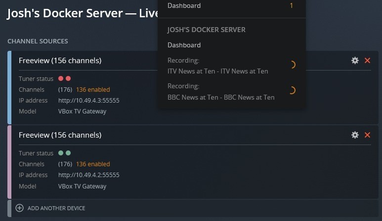

I use VBox with the Plex EPG (based on location, not XMLTV data), which works well. However, I have recently purchased and added a second VBox tuner, and although Plex picks it up, I cannot get it to function.
Plex appears to default to the original VBox, which is fine, however, when both of those tuners are locked, for example when recording TV shows, it then attempts to use the additional VBox. However, every time I attempt to tune into a channel, I receive the message ‘Could not tune channel. Please check your tuner or antenna’.
Plex Error
I have tested the second VBox via VLC and all streams are OK. My only thought is that perhaps there is an issue with the Plex EPG, not utilising the additional tuners available on the second VBox?

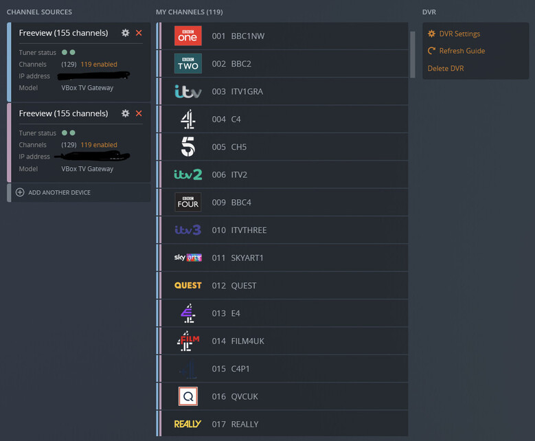

I have reconnected both my VBox units and this is the state of play…
PMS & VBox’s are both up-to-date.
I can connect a single VBox using the Plex EPG, download guide data, and things function just fine. However, if I attempt to connect a second VBox, this is where the problems occur - I receive an error of “Could not tune channel. Please check your tuner or antenna.”.
I cannot tune to any channels using either box. I have checked and this is not an issue with either VBox - both serve streams just fine if I manually connect using VLC.
