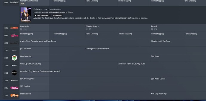

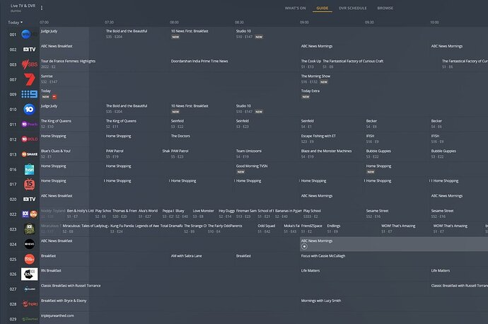

I’m not sure what you mean. My VBox channel listings are shown below:
When selecting to play the Channel 7 TV station within the Plex Media Server app on my Synology DS(equiv.), I selected the first Channel 7 entry from the Live TV Guide data presented by the PMS; that’s channel 007 in the screen capturebelow:
The whole of the channel listing from my Plex Media Server (including Radio channels for Sydney region) are shown below.
