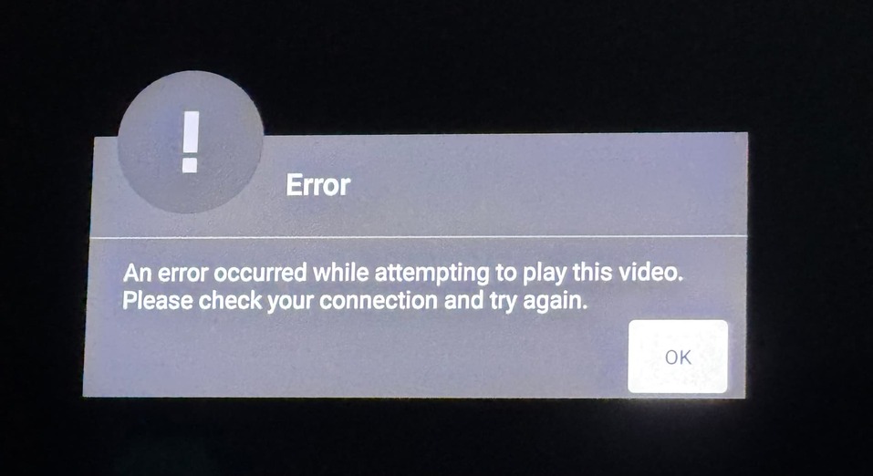

Testing on latest beta as per your comment. get this error within minutes of starting live tv stream on android tv
did new beta version work for you? ill grab logs and upload soon. happens when i open live tv stream on Android TV plex client (I have 4 - 2 of them are nvidia shields and the other two are android tv smart tvs).

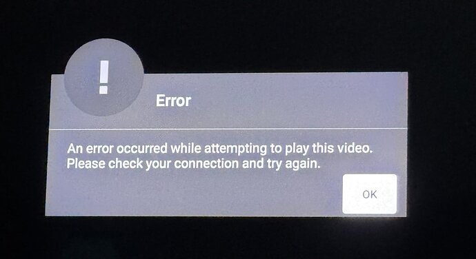

Yes, the error still persists and is specific to Android TV - I have a 6 Android TV’s in my home and a mixture of devices all running Android TV OS and they all have the same symptoms (Other OS such as Apple TV and IOS seems to stream fine). Stream will run for a for up to 15 minutes fine and then suddenly crashes with this error (see attached) - from the same sources on Jellyfin and other clients, no such issue. Other than already attached logs here, nothing obvious sticks out in logs.
