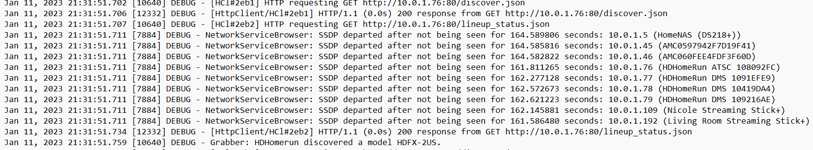

I fired up wireshark and did not find any network related errors, but strangely enough, I noticed ICMP traffic going to my old (retired / offline) plex server. I then found the IP in the Plex logs, but I can’t figure out where this reference may live. Any thoughts anyone?
The old retired / offline server IP is highlighted in the screenshot.
EDIT: I recognize the ports now as old xteve ‘tuners’ from my old server. Where are these values being stored, as these are not exposed as tuners in the UI. The old server was fully decommisioned.
Okay, I found the entries in the database. Do I simply need to stop Plex, delete the rows where uri like ‘%10.0.1.10%’, and then restart Plex to get it to stop trying to connect to these tuners which no longer exist?
It’s safe to delete everything in media_provider_resources but you’ll probably need to re-create the DVR.
