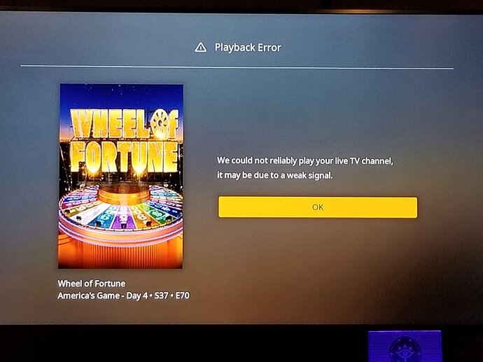

I’m regularly getting this error when watching live TV via Plex:
“Playback Error
We could not reliably play your live TV channel,
it may be due to a weak signal.”
The error generally occurs within a few minutes of streaming. Sometimes the stream will work for 30 seconds or so without any issues, but then it will start artifacting, buffering and eventually the stream stops and gives me the above error.
I’m using an HDHomeRun Quatro. Live TV worked fine via Plex until just the last few days. I don’t know of any changes unless there were server updates. I can watch live TV perfectly via the HDHomeRun app, so I know that the problem isn’t the tuner or the antenna. I run into this error on both Roku and Android, so it’s not limited to just one platform and seems to indicate an issue with the server.
Any ideas as to what could be causing this?
