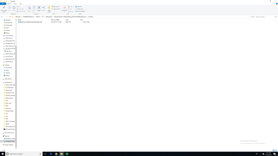

I have it checked but it still doesnt show. I have my file in the westworld folder named Welcome to Westworld - behindthescenes. I refreshed metadata and nothing appears.
Here is my file structure. Is this correct?
Here’s the recommended file structure for adding a featurette (just choose one of the Welcome to Westworld positions depending on your requirements)
  • Westworld
    • Season 01
      • Westworld - S01E0x - episode name.mkv, etc. All episodes
      • Welcome to Westworld-featurette.mkv Example of inline extra that will be added to season 1 - will be added to the server, but won’t show up in Plex Web
      • Featurettes
        • Welcome to Westworld.mkv Example of subfolder extra that will be added to season 1 - will be added to the server, but won’t show up in Plex Web
    • Welcome to Westworld-featurette.mkv Example of inline extra that will be added at the show level
    • Featurettes
      • Welcome to Westworld.mkv Example of subfolder extra that will be added at the show level
If you search this thread, you should get a good idea of which clients support season extras and whether it is worth adding them.
Other extra type names are listed on the GitHub page, “Specials” is not among them because that is already in use by the Plex Media Scanner, and you could end up with real specials episodes also being added as extras.
