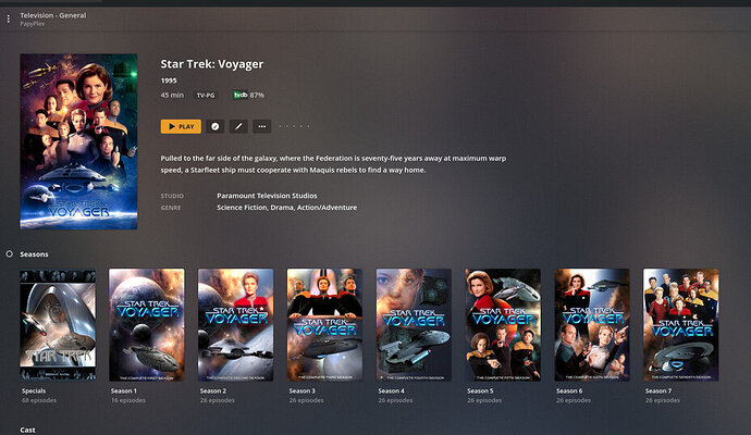

I can verify Local TV extras are working just fine
Please show me how you have it structured and then show me your naming for one series which does not obtain local media assets.

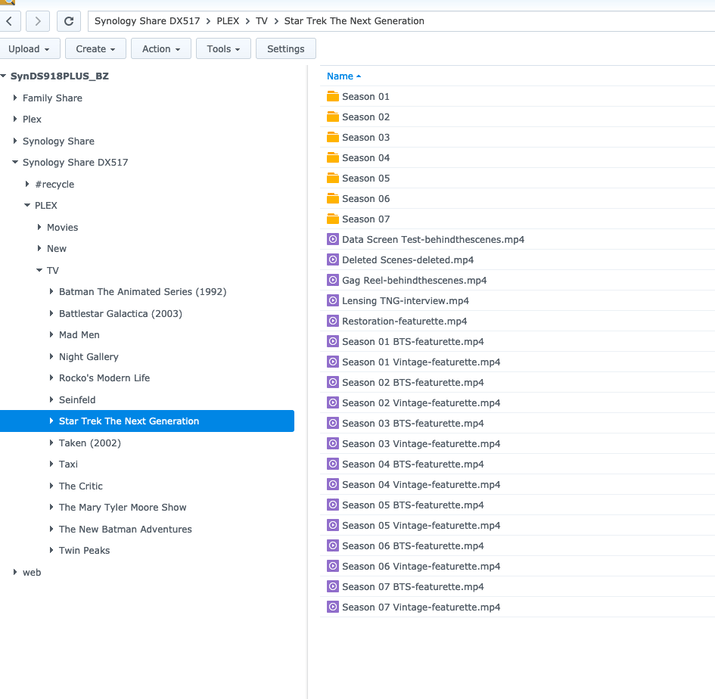

May I see some examples of naming & structure please?
Will send you screenshots when I get home. I believe I am on DSM 6.2. Files are named as…
For Example…
Star Trek The Next Generation/Extras/Deleted Scenes-deleted
Episodes are named as…
Star Trek The Next Generation/Season 01/Star Trek the Next Generation - s01e01 Encounter at far Point
I’m only trying to get the extras to show up on a show level (season and episode not needed).
Well… there you go.
Plex does not read from a folder named Extras.
Try something like this instead:

All right this seems to have done the trick, but I just want to say it looks super messy on my file system and what’s annoying is that the extras don’t get laid out in numerical/alphabetical order. At least they show up now. I think it’s really bizarre that a third party developer was able to create something on their own for free that functioned better than this.
