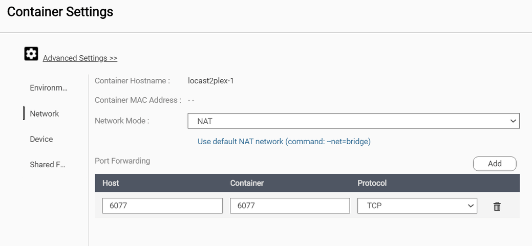

I just installed locast2plex via container on my Qnap which is also running my Plex server below log looks like it is working but when I try to connect to it from Plex on DVR Setup I get “There was a problem adding the device: 10.0.10.4:6077” 10.0.10.4 is the IP address for the Qnap.
Any thoughts on how to troubleshoot?

For those wanting to set up Locast2Plex on a Qnap, I finally got mine running and am able to DVR my local channels. See my posts at Error during login: · Issue #85 · tgorgdotcom/locast2plex · GitHub. I set up a docker in Qnap Container Station by login via SSH and running:
docker run \
-v /share/CACHEDEV1_DATA/yourdirectory/config.ini:/app/config/config.ini \
tgorg/locast2plex
where yourdirectory is the folder where you have the locast2plex config.ini. Here is the basics for that file below. The script above references the .ini file to build the container on Qnap.
[main]
locast_username=username@example.com
locast_password=1234567
plex_accessible_ip=127.0.0.1
I have 127.0.0.1 specified since my Plex is running on the same box. If not use the network ip for the server that is running plex.
I then used 127.0.0.1:6700 in my Plex DVR setup. Plex would not connect until I went back to the Container Station on Qnap and added the 6700 port for the docker per screen shot attached.
I hope this helps anyone attempting to run this for their Plex installation!
