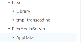

I managed to figure it out, for some reason I still have the old plex filesystem. I assume from DSM 6 to 7 and migrated plex accordingly. I was changing the preferences.xml file in the old plex files as appose to the new ones. :man_facepalming: After, i changed the preferences.xml file in the new plex folders, i tried my normal IP, and it popped up allowing me to reclaim the server immediately. Hope I’ve explained that right :rofl:, Just glad to be back in tbh.
Do you know whether or not I can delete the old files?
Screenshot 2022-03-16 174434
