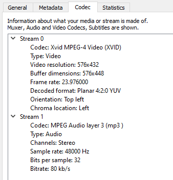

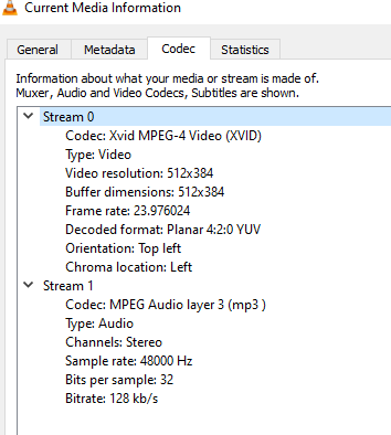

Media Codec examples (seems to be Xvid on all):
image image image
I will also add that I got other episodes in the same shows with the same codec and file format that is found on scan.
