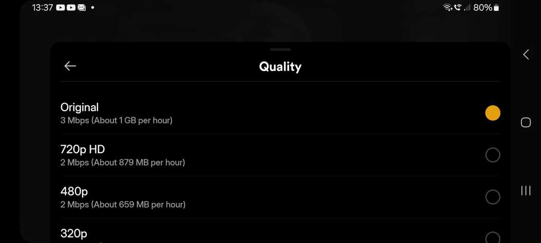

Just to make it more confusing now, when I play a video on my Android phone, the quality is much better and Plex states it’s running at original quality @ 3Mbps, meanwhile playing a video on my laptop (using the app, not a browser) is still @ 0.7Mbps/320p.
It just doesn’t make sense to me and I’m sure every platform use to play at original quality.

Yes, but the laptop is streaming at just 0.7Mbps/328p while the phone is streaming at 3Mbps/1080p, that’s a big difference in quality. Both are on the same Local Network, not local to the server though.
I don’t get it and there is no option to increase the resolution in Plex on the laptop, apart from decreasing it.

Regardless, the Android phone still streams at 3Mbps while the laptop at just 0.7Mbps along with all the other platforms such as my brother’s TV.
It’s frustrating especially as I don’t understand what’s going on. I wonder if it’s anything to do with my my router but the fact that my Android phone can play ‘Original’ quality as stated in settings makes it bizarre.

Where are you reading 3Mbps? In your screenshot, I’m seeing 635Kbps.
Sorry, Im not sure what you mean. I’m streaming from Plex apps on all sorts of devices that are connecting to the server remotely.
I’m reading it from the Plex app on my phone as I play the movie.

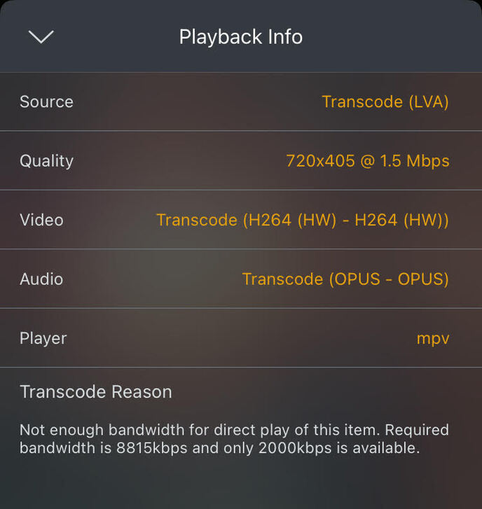

I suspect you are looking at the wrong values, possible settings and your set parameter, not the figure the video is actually playing at, regardless of your setting. You can provide your preferred setting but the video will still play at the possible quality. Look at it as the maximum possible quality. To see the actual value, click on the 3 dots on the screen showing your video playing and select info, not settings. That should also give a reason why the video is being downgraded. As an example, this is what I see on an iPhone.
Thanks, unfortunately I can’t see an option that says ‘info’ apart from the details of the original file. That said, after flicking back and forth between 3Mbps/1080p and 0.7Mbps/320p I can visibly see the difference in quality.
