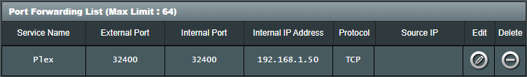

Port forwarding configuration screens vary by router manufacturer, but they all have the same basic information. Here’s an example from an Asus router:
The Service Name does not matter. It is just a name.
Internal IP Address is the address of the Plex server.
Source IP is left blank, since you will not know the IP address of the remote user (it changes based on location).
