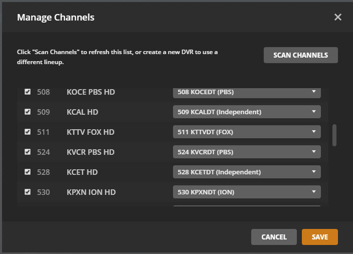

I actually deleted the HDHR’s from Plex, then re-detected them and initiated a new channel scan, so I would assume that Plex should not have any knowledge of this channel.
and looking now at the 'manage Channel window shows that Plex does not see ch 517 on either HDHR Prime:
Hoping that it was just a delay at cleaning up after itself, I went to the program guide to verify that perhaps 517 was not showing… and and no dice, channel 517 is here, when it should not be. I’ve got it blocked at the tuners via HDHR software. I’ve deleted the tuners and re-added them. I’ve verified the tuners don’t even have a check box to check or uncheck channel 517. Yet, it is still there in my program guide.
