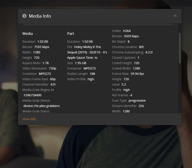

I did some checking last night and this morning and pulled the XML you requested.
I noticed that it did not change between the original file and the modified file…I guess that makes sense because I kind of pulled the rug out from underneath.
Anyway, the media info did clearly show a size value that reflected the original file size:
Size 1.95 GB
and I can see where it is getting the value from the XML:

I also noticed that the original file is owned by Plex user and the modified is if course owned by me. Maybe I need to do a chown on it as well.
