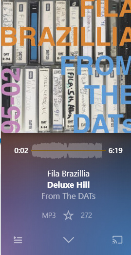

Manual analyze music doesn't seem to be working at all. No loudness/soundprint data. (except for new files that are added)
Hello,
So I recently completely migrated my Plex server from my computer to a Synology DS920+
Thankfully everything went smoothly when transferring metadata from one hard drive to another, but I cannot get the analyze music function to work at all. After the move, only very few of my tracks in my music library still have loudness data attached, a vast majority does not have any loudness data anymore (my old server had loudness data on pretty much everything).
I tried analyzing the entire library, I tried analyzing individual albums, but nothing seems to work for the exception of new music files being entered into the server. I would like to avoid creating a new library just so I can get loudness data / soundprints for my previous library.

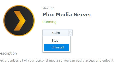

I invite you to:
  1. Remove anything Plex
    a. Control Panel - Shared Folders – Remove the Plex share
    b. Control Panel - Users - Remove user Plex
  2. Uninstall the package
  3. Restart the Syno
  4. Download and install from either Plex.tv or Synology (your choice)

I’m getting loudness data now.
Thank you ChuckPa
