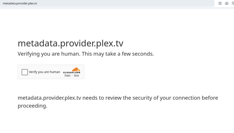

Update, when I load the plex metadata request URL into a browser on the same server as plex, it gives me a cloudflare verification check. Not using any VPNs and I’m in the united states. The plex container is seeing my public IP as well. This could be why the request is failing. What would cause cloudflare to force a verification on my end?
The same cloudflare verification check happens with https://metadata.provider.plex.tv as well, on a web browser and curl within the plex container.

Thanks, somebody is taking a look to see what’s causing this for you.
Would you be able to DM what the IP address these requests are connecting from?
Thank you!
Sent.
Looks like Cloudflare had set a high threat score on my IP which was causing it to be forced to make verification checks. After talking to cloudflare they seemed to think it wasnt any intentional activity on my network.
Long story short, I got a new public IP from my ISP and I can now use all plex services again. Issue resolved!
