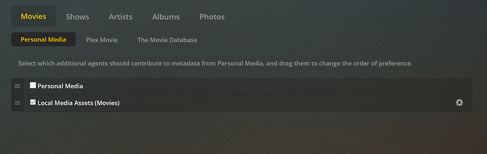

Hello,
I’m facing the same issue as well. OS is Windows 10 however.
Attached are logs.
Primary agent for Movies is “Plex Movies”.
The exact order for each field is as follows:
Movies > Personal Media
Personal Media
Local Media Assets (Movies)
Movies > Plex Movie
Plex Movie
Movies > The Movie Database
Plex Movie
The Movie Database
Hope this helps!
@phil0115
I’m not understanding how you mean those.
Would you mind taking a moment and grabbing a few screenshots?
(It’s been a LONG day here)
Can you point me in a direction regarding what’s not being found? Movies?
Fetching metadata for movies does not yield any results, TV and Music work fine however.
Screenshots attached.
