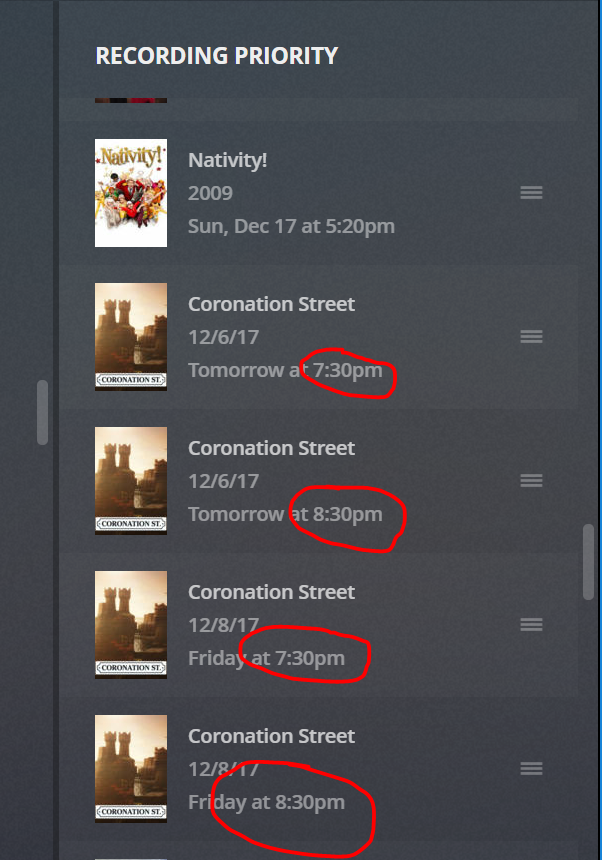

Using HDHOMERUN Connect tuners (2x units on LAN - ie 4x tuners) + latest 1.10 Plex server. Based in UK - EPG provided by YOUVIEW.
The repeatable issue I’m having is that the second of a sequence of (HD) TV shows is missed. After the missed recording it doesn’t show up in the ‘recording schedule as missed’ it just doesn’t show up - but it did show up in the future recording schedule (before the recording).
So PLEX knows that 2x TV recordings should take place - it processed the first one, but then entirely misses the second.
TV show #1 is 19:30 - 20:00 (with the +1 min means 19:29 - 20:01) - records OK
TV show #1 is 20:30 - 21:00 (with the +1 min means 20:29 - 21:01) - never records
Is there something I’m missing (besides being able to watch the second episode each day)?
Here are a few screen shots… Not sure if the duplicate Episode may be the cause of the problem (and how to solve - re EPG)?

I’ve been overlapping these two recordings for months and it’s never produced an issue, but in your case, both of the recordings are the same episode, in which case I believe Plex skips the second episode by design. New and Repeat Episodes causes the first airing of Coronation Street (which is not indicated as a new airing) to be recorded, but only if the episode is not already in your library; the second airing should not be recorded, because the first airing was recorded successfully. Can you give us any insight into why you want the second airing of the same episode to be captured, or is the guide data misleading?
Edit: Ah, I see that they are in fact different episodes from your second screenshot. The guide data indicating them as the same episode is surely the culprit here. Perhaps another user will have an idea, but I see this as a YOUVIEW problem rather than a Plex problem. Perhaps another U.K. user will have some insight. In any case, I would attribute the problem to the airings being listed with the same episode number (12-06), rather than the schedule overlap.
Search the forum with text Coronation Street, known issue that Plex is looking into. Issue is the guide data shows the Season/Episode as 12-06 for both episodes. Plex shows them both scheduled to record because episode 12-06 does not exist in the library. Once the first show records and is put in the library Plex then sees that it has episode 12-06 and cancels the recording of the 2nd episode.
@fecaleagle issue is basically the guide data. If they listed the shows with a valid season/episode number instead of month/day this problem would not happen. As I understand the 2 episodes are Part 1 and Part 2 of the show for that day. TheTVDB lists the 2 shows for 12/06 as Season 58 Episode 252 and 253. If the Guide data showed 58-252 and 58-253 for the 2 recordings Plex would record both.

you have all been really helpful and yes, the two shows (different) having the same series/episode reference 12-06 is the clue to the failure to record the second (valid) episode on the same day.
