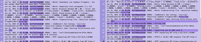

I made a diff of the Media Scanner Matcher logs for the mp3 file and the flac file. The only difference seems to be that something kills the child job in the flac case (though it says it exits successfully)
