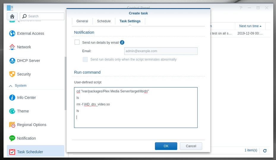

Here’s an easier way. We’ll use Task Scheduler
Control Panel - Task Scheduler
Create a Scheduled Task - User defined script (we’re only going to use this one time)
We give it the commands to delete the iHD driver
Now we Highlight and then Run the task.
When done, Restart PMS.
Confirm all works
Delete the task.
We don’t need it anymore.
The commands for the Task Settings are:
cd "/var/packages/Plex Media Server/target/lib/dri"
ls
rm -f iHD_drv_video.so
ls
