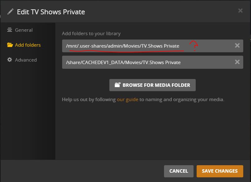

When picking the library path, Plex adds /mnt/.user-shares/admin which doesn’t even exist!
See screenshot where the first is the changed path it updated on it’s own, while the bottom path is the path I entered for comparison. I think have to delete the one on top and things are back to normal for a while.

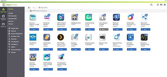

No, don’t use filestation at all. Maybe I need to just watch and see if it does it again. Would another app be able to change preferences and settings inside the plex-server database anyway? This NAS doesn’t have much installed on it at all, and nothing has been added for several months now. This has happened twice in the last couple weeks and I haven’t been able to peg down what could cause it. Apps below.

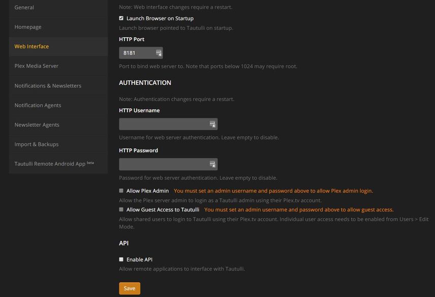

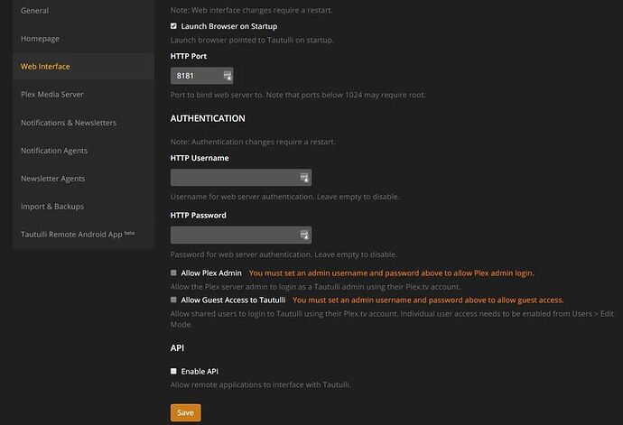

PlexPy doesn’t permit you to remote-admin the server AFAIK …
BUT
If you have remote access enabled in PlexPy AND the default password (or an easy one), you’re vulnerable.
Plex.py is just for internal usage and stats as its not available outside the firewall. It’s essentially a log viewer. None of the admin or allow guest stuff is enabled. I can’t think of anything else that would connect to Plex.

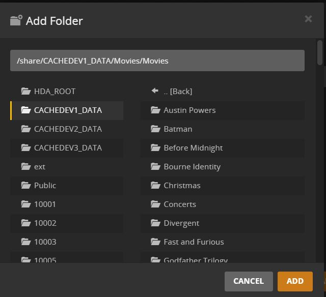

So if I pick the above path in the Add Folder picker for a library, it gives me:
But if I pick the direct path via the device and not the QNAP symlinked path listed above, then I get:
The point is, the path Plex is making up when using the symlink path doesn’t exist. There seems to be some error in the directory picker logic here… I would prefer to use the Symlinked path as device ID will cause problems if moving devices. For example, a TS-569L the path is “/share/MD0/Movies” with a symlink to “/share/Movies”. On my TS-877 it is “/share/CACHEDEV1_DATA/Movies” as shown above. But on both systems the symlink of /share/Movies works on both device which is where I would point Plex. This is why QNAP uses this logic of obscuring the device ID.
So where is plex getting this /mnt/.user-shares ??
BTW - I can manually type the path “/share/Movies” and it will respect me forcing the path, but just know this is not available in the picker mode because it adds /mnt/.user-shares
