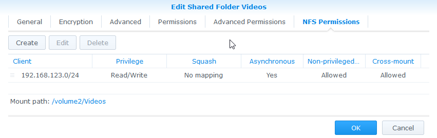

  • NFS is active without v4.1 on both sides
  • NFS rules are set (*, R/W, no-mapping, sys) on both the remote folder (old-NAS) and mount (Plex-NAS)
  • Permissions are set to R/W on both Plex user and Admin
  • NFS mount is successful (v3, TCP) on Plex-NAS and i can perfectly browse the remote folder and sub-folders/files within (Old-NAS)

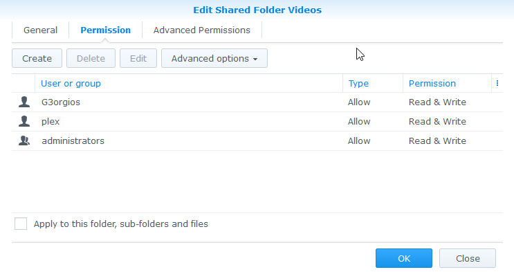

@trumpy81 did as suggested and “reset” the permissions on the remote folder as you say. Still the contents of the mounted folder are not visible. Should I recreate the “plex” user on the remote server? It was created something like ages ago (probably since I was running Plex on that machine before migrating to the new Synology). Is the password my Plex account password?
Also, if NFS does not relate to usernames, is the “plex” user relevant? [CC: @ChuckPa]

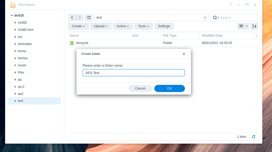

  1. Create a directory to mount to (safest)
  2. Mount to that directory
  3. Fill in the URL IP.addr.of.host:/volume/share-name
  4. Use “browse” to have it mount to the freshly made directory and mount

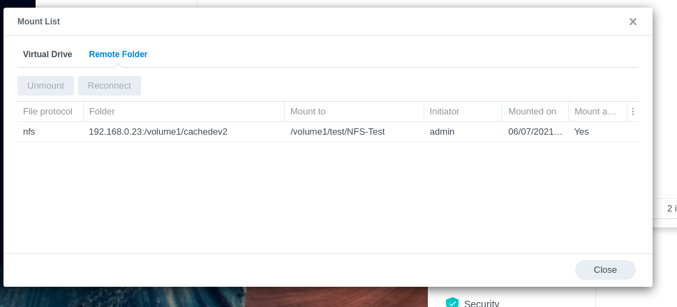

  5. List the current Remote Mounts to confirm (Tools → Mount list)
  6. Browse, select, drag and drop
@ChuckPa I always use a “Mounts” share-folder to map remote folders. The mount operate flawlessly via the the file-station, meaning I can read, write and execute (view/edit/delete files/folders). The NFS mount of course shows live in the mount list:
and of course, NFS permission are properly set

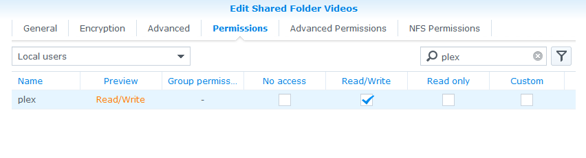

Strangely, ONLY Plex (running on the same machine with the mount) seems unable to see the contents within the mount. Same behavior if “plex” user has R-only or RW access rights, also regardless of doing so from within the shared folder properties (remote server)
or setting permissions manually via the file station

@trumpy81 i had tried in the past but did it again to make sure. Deleted the class-C IP share and used * exactly as in your snapshot (async, ports, subfolders). Still same behavior, mount works fine on file-station, Plex sees it but not the contents within…
BOTH the remote folder AND the local “Mounts” folder have same NFS permissions.
@trumpy81 latest Plex version running:
I have removed the NFS permissions from the “Mounts” shared folder. Of course the remote folder has them, exactly as in your snapshot (*, async, ports, subfolders) and thus is fully accessible via the file-station. Still no luck for Plex to see the content within the mounted folder…
