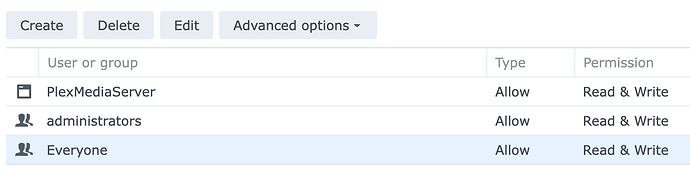

Edit: ah wait, i managed to find it, right-click on map, permissions, then create and select EVERYONE, tick read and write. Save. But still Plex is not able to find the files in the folder when scanning
Apply to sub-folders and files!

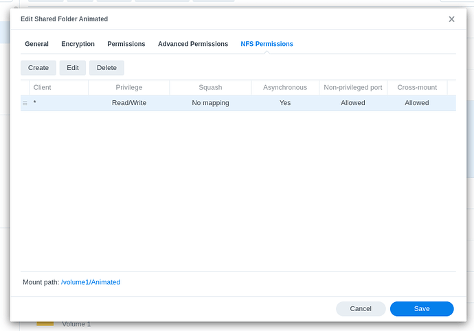

I do NFS this way:
  1. No mapping / squashing
  2. Now “everyone” comes in.
Otherwise, when you squash to ‘admin’, you need to go back and force ‘admin’ on all your media (makes things too complicated)

I now set the NFS permission exactly as you have.
In File Station, right-click folder, properties, permissions, added EVERYONE with read&write.

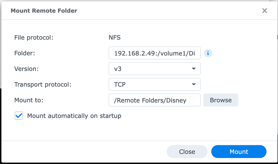

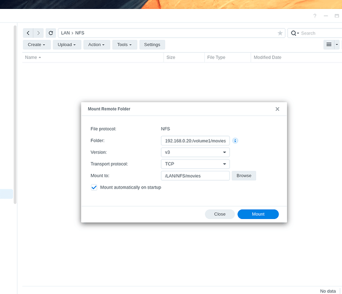

  1. is the folder mounting?
This is what it will look like right before you make the mount

  1. Yes

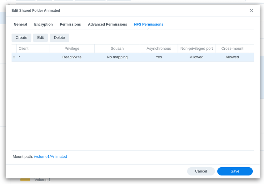

  3. NFS rule permissions
“Everyone” is allowed on BOTH sides of the NFS mount?
(Both machines)
Yes, the screenshot i provided at my previous post at nr2 is exactly the same on Syn1 and Syn2

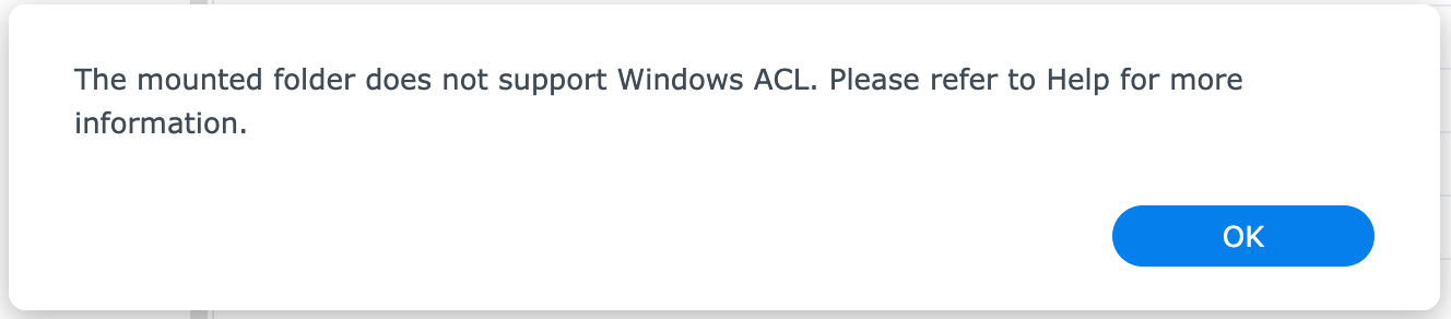

Maybe something to mention, but maybe it will not effect the permissions at all, but when trying to set permissions on Syn1 on the folder \Remote Folders\Disney it will give this message:
I can only set permissions on \Remote Folders
