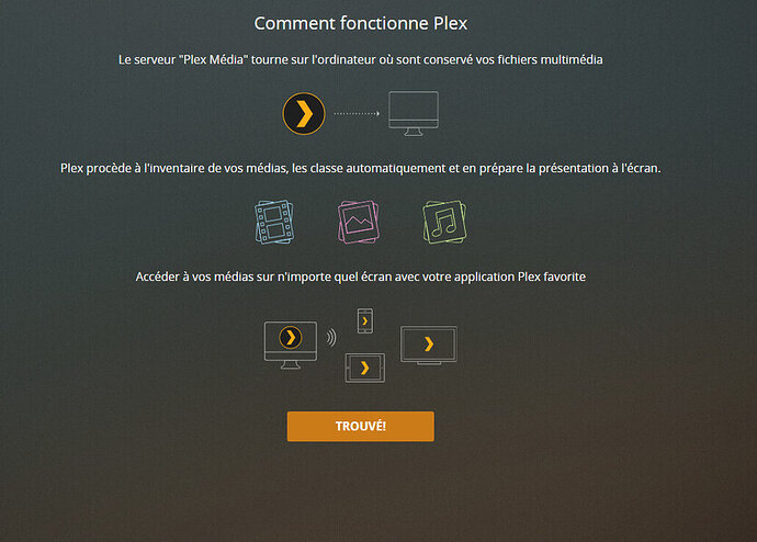

  6. Go on the PC to do the setting (I did not change anything). I am talking about this
