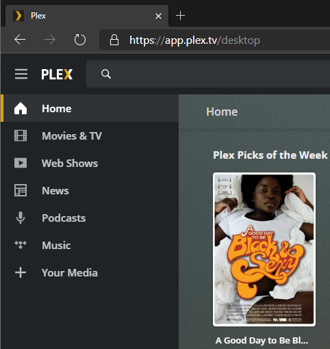

Here’s what I see when using my test account. I’m on the same network as my server, so I don’t have to worry about remote access working.
I’m not logged in at this point, so just see Plex’s online media sources.

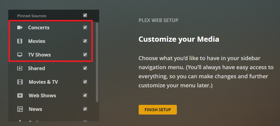

I login and go to settings -> Plex Web -> General and click on Reset Customizations.
This appears in the middle of the browser window. The top three are the shared libraries. The rest are the online media sources. I select the ones I want and choose Finish Setup.

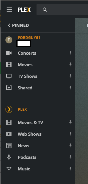

I then see all the pinned sources on the home page.
Screenshot (98)

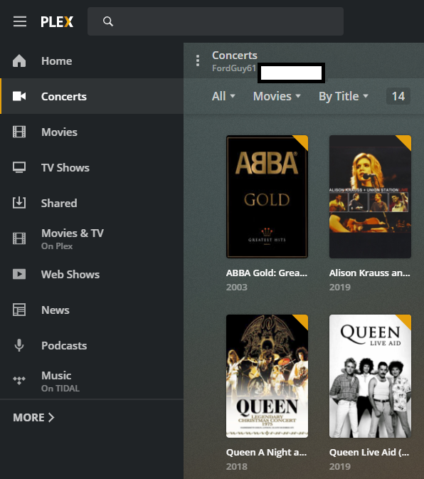

If I click on “More>” it shows me my server, the shared libraries and the online sources. I can choose what to pin, etc.

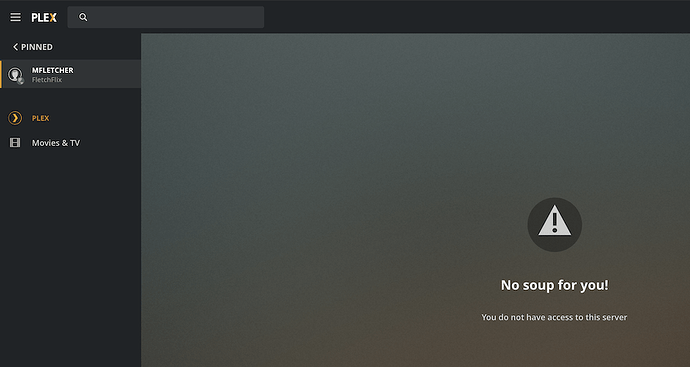

  • In my test account, I reset the customization and now see the shared server but no libraries even though both accounts show 2 libraries are shared.

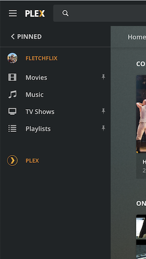

Here’s what I see in my main account:
Here’s what I see in my test account:
