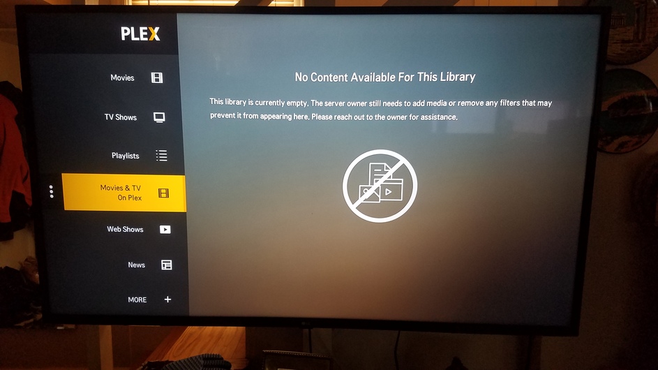

Movies & TV on Plex
when selecting Movies & TV from Plex.
“no content is available in this library.”
The server owner still needs to add media or remove any filters than may prevent is from appearing here. Please reach out to the owner for assistance"

That TV should work. Can you provide a screenshot? I don’t think I’ve actually seen that error.
I’m having the same issue. I’m on WebOS 3, but the Movies & TV function was recently added to it:
I assumed the feature was just not yet “turned on” even though it it now shown. :man_shrugging:

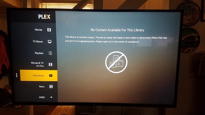

as you can see. news works
but Movies & TV On Plex and WebShoes doesnt work.

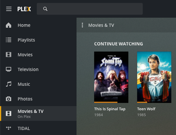

on my Mac however
it does display content, just not on the TV.

on my Mac
Movies & TV On Plex shows programming.
