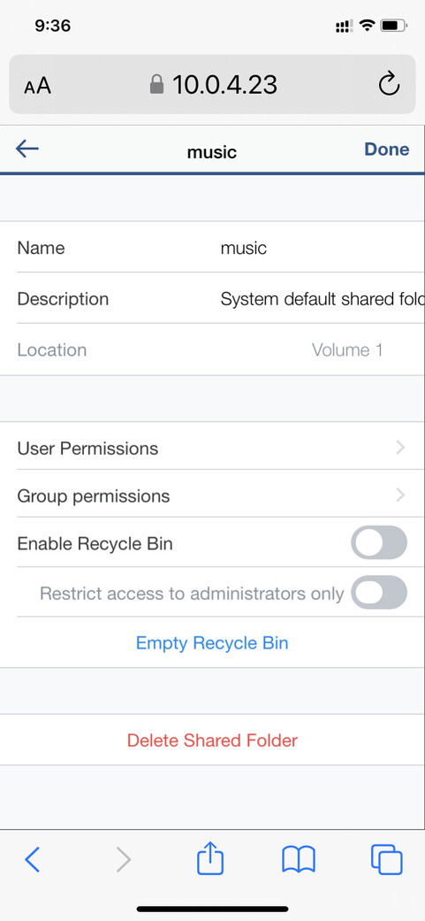

My music is correctly labeled (volume/music/artist name/album/track) but when I added the library in Plex it shows as empty. When I try to scan it shows scanning for about 1 second then says cant find anything. Ive stopped and started the server but no joy. Plex has read/write access to the music folder so I’m at loss as to the problem.

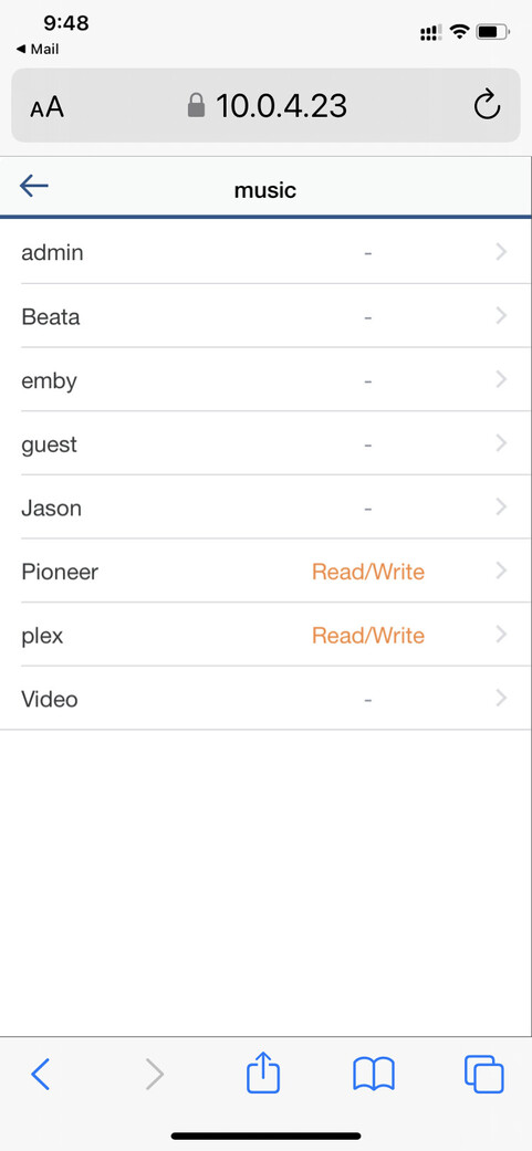

I’ve checked the permissions folder for my music and it’s the same as for tv and movies yet doesn’t seem to want to scan. Is there anything else I’m missing?

I fixed it thank you, was a deeply buried permissions check box that was overlooked.
