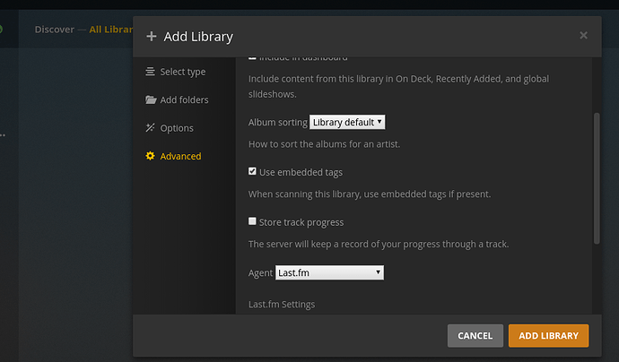

Reading embedded tags is disabled by default.
It is in the Advanced tab. Please see below.
Thanks. As mentioned in the original post, I have enabled embedded tags.

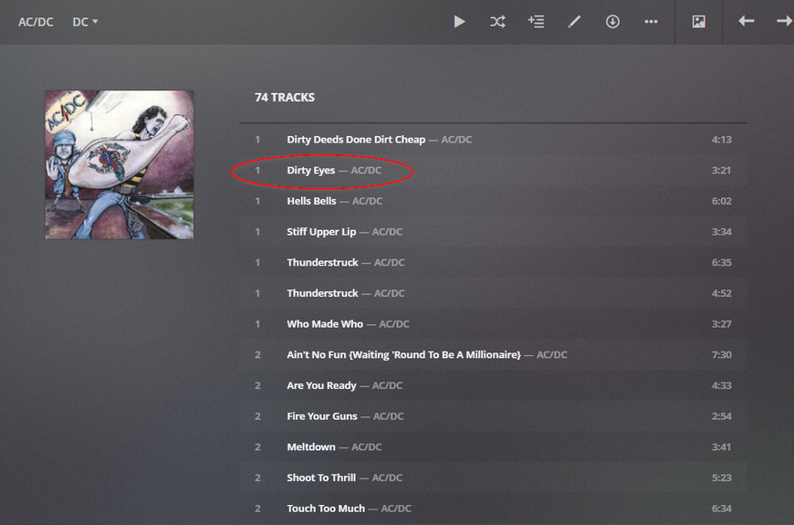

Thanks for the info. I seem to have managed to get Back in Black registered properly after changing the folder name to ACDC, but all the others still show “DC” as the album name. Here’s an example of one of the bad tracks. It’s in a sub-folder that has dashes, but there are plenty of other mis-registered tracks that aren’t in subfolders like this. Any ideas?
Here’s info from one mis-registered track on the server:
user@machine:/media/Music/folder/ACDC/22-ACDC-1997-Bonfire/03-Volts$ mp3info 01-Dirty\ Eyes-mw.mp3
File: 01-Dirty Eyes-mw.mp3
Title:   Dirty Eyes                     Track: 1
Artist:  AC/DC
Album:   Bonfire - Volts                Year:  1997
Comment:                                Genre: Rock [17]
And here’s the Plex XML for that same track:
<MediaContainer size="1" allowSync="1" identifier="com.plexapp.plugins.library" librarySectionID="4" librarySectionTitle="Music" librarySectionUUID="51f171b2-4220-48fd-9bc3-5ea8bd51e05e" mediaTagPrefix="/system/bundle/media/flags/" mediaTagVersion="1540920214">
<Track ratingKey="5946" key="/library/metadata/5946" parentRatingKey="5945" grandparentRatingKey="5838" guid="com.plexapp.agents.lastfm://AC/DC/DC/1?lang=en" librarySectionTitle="Music" librarySectionID="4" librarySectionKey="/library/sections/4" type="track" title="Dirty Eyes" grandparentKey="/library/metadata/5838" parentKey="/library/metadata/5945" grandparentTitle="AC/DC" parentTitle="DC" originalTitle="AC/DC" summary="" index="1" parentIndex="1" ratingCount="12765" viewCount="15" lastViewedAt="1536523369" thumb="/library/metadata/5945/thumb/1541501822" art="/library/metadata/5838/art/1541584114" parentThumb="/library/metadata/5945/thumb/1541501822" grandparentThumb="/library/metadata/5838/thumb/1541584114" grandparentArt="/library/metadata/5838/art/1541584114" duration="201046" addedAt="1452677590" updatedAt="1541584132">
<Media id="5208" duration="201046" bitrate="128" audioChannels="2" audioCodec="mp3" container="mp3">
<Part accessible="1" exists="1" id="570448" key="/library/parts/570448/1541501121/file.mp3" duration="201046" file="/media/Music/folder/ACDC/22-ACDC-1997-Bonfire/03-Volts/01-Dirty Eyes-mw.mp3" size="3217408" container="mp3">
<Stream id="1041993" streamType="2" selected="1" codec="mp3" index="0" channels="2" bitrate="128" albumGain="-7.96" albumPeak="1.000000" albumRange="10.182369" audioChannelLayout="stereo" gain="-9.75" loudness="-8.25" lra="3.32" peak="1.000000" samplingRate="44100" displayTitle="Unknown (MP3 Stereo)"/>
<Stream id="1043449" key="/library/streams/1043449" streamType="4" codec="lrc" format="lrc" minLines="3" provider="com.plexapp.agents.lyricfind" timed="1" displayTitle="Unknown (LRC External)"/>
<Stream id="1043450" key="/library/streams/1043450" streamType="4" codec="txt" format="txt" provider="com.plexapp.agents.lyricfind" displayTitle="Unknown (TXT External)"/>
<Stream id="1042136" key="/library/streams/1042136" streamType="4" codec="txt" format="txt" provider="com.plexapp.agents.lyricfind" displayTitle="Unknown (TXT External)"/>
<Stream id="1042138" key="/library/streams/1042138" streamType="4" codec="txt" format="txt" provider="com.plexapp.agents.lyricfind" displayTitle="Unknown (TXT External)"/>
</Part>
</Media>
<Extras size="0"> </Extras>
</Track>
</MediaContainer>
Here’s what it looks like in Plex. Notice that in this case, tons of tracks are getting placed in a single album…
I don’t understand the 22 at the beginning of the album folder title.
Is this some kind of ordering tool, to have your albums sorted?
I also think that the abundance of dashes in the folder titles doesn’t help with your issue. I suggest replacing them with dots or (even better) with regular spaces.
The dash has a special meaning to the Plex scanner. It is used to separate album title and artist from each other. It is very likely it gets confused if there are too many dashes in there.
