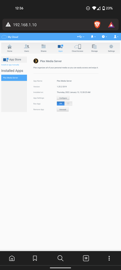

On the APPs tab, when you click on Plex, what’s the version installed? Does my cloud home allow you to install external apps? If yes, install the version from here
It looks like it’s running 1.18.6.2350. I don’t believe it allows any installations or updates from external sources.
