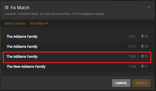

I tried it without the year in the folder/file names. Plex matched it to the 1992 animated version. Fix Match corrected the mismatch.
The fix match finds The Addams Family (1992).
In Fix Match, select Search Options.
For the name, enter 77137, the series ID from TheTVDB.com. Clear the Year field, if populated.
Search should return the 1964 series.

The other thing you’ll notice is that the different Agents return different results.
Using the TheTVDB agent returns just the 1992 animated series, using default search parameters. It will find the 1964 series, but you have to change parameters, such as using the series ID.
The Movie Database agent returns more hits, listing four versions of the show. No need to search with show ID, etc.
It is not always the case that The Movie Database returns more hits. You may see different results with other shows.
