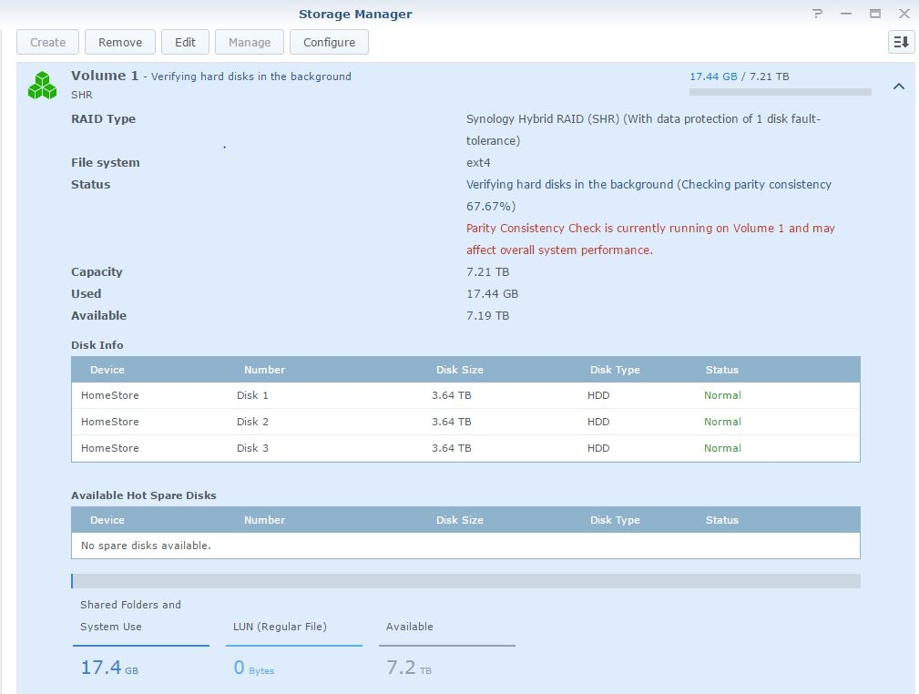

I am wondering, because my Nas is still checking volume parity (has been all night!) could that be effecting it?
Does anything look not right on this screen to you Chuckpa?
No, Storage Manager performing its tasks will only impact overall performance.

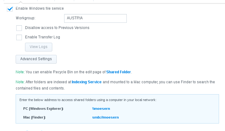

Go to Control Panel - File Services. Make sure you didn’t disable the Windows file services or change the WorkGroup.
Here that is. It says WORKGROUP on my computer (windows) I have a Homegroup ?

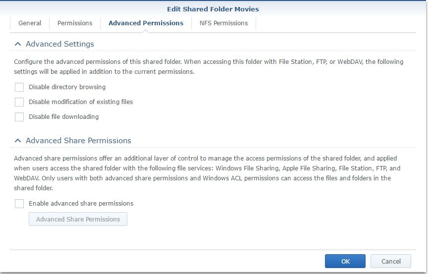

Also here are my permissions for current shared folder movies, which has 1 movie file in for testing.

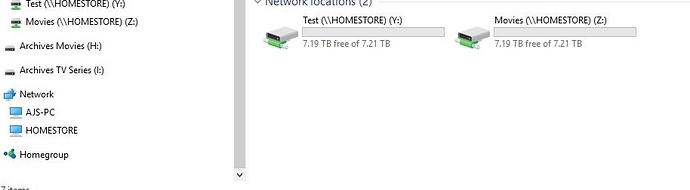

Apologies i missed the guest suggestion. I have now enabled to no success. Am I mounting it wrong. I use the My Computer > Map Network Drive > Choose Letter > Browse to Movies folder > Tick the connect using different credentials > Then when prompted after clicking finished > Login in with my read write account on synology. I see these synology mount settings (Last pic belowpic below) I haven’t touched them though.
The credentials you used are your Synology username and password (Case Sensitive) ?
Yeah the credentials are correct because I tried mounting it again, and typing password incorrect and it just keeps challenging you for user/pass. When I put the right on it finishes and the drive is accessible via my computer etc.
