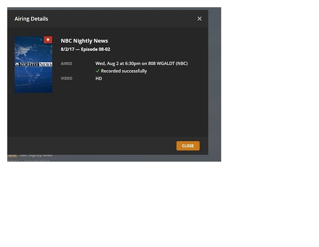

I had a recording set to record NBC news off my HDHomerun prime. This used to work. Now it doesn’t. I have the same settings for ABC news and that seems to contiune to work.
