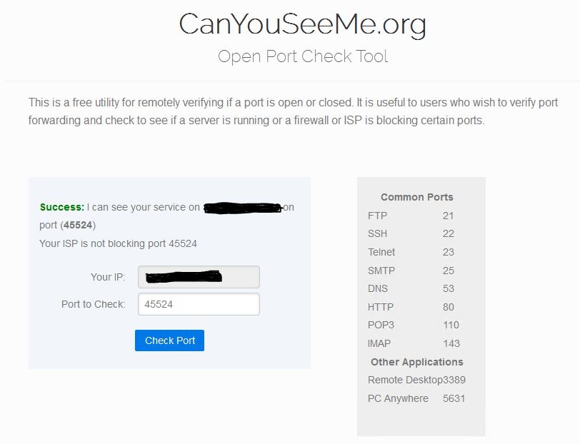

I tried the open port check and the port is open, yet still no joy from plex.

The port you are trying to get to via canyouseeme.org is the same port you have forwarded to port 32400 inside the network as per the instructions in the support document? (WAN side ##### : LAN side 32400)
If you forwarded say 45524 outside to 45524 inside that won’t work. Plex is listening only on 32400 or 32401 even if you have it check marked to use another port in the settings.
