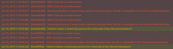

Although i am still not able to play the music files. I looked into the console and filterered by errors and warnings and got the info in below
This made me rethink about what Tiebierius suggested previously. So i went and tried to analyze my music files. No matter what i did manually, at the library level, album or track, analyzis didn’t seem to start. Is this normal or expected? So, i went to settings and configured it to run deep analysis during maintenance as a scheduled task. I had to tweak the time for scheduled tasks to start. I was able to see that the butler had analyzed x items. Although when i try to play my music files, they just don’t.
I attached my device to my laptop and i can play the files without any issues on many different players.
I’m running out of ideas here. Can anyone help? I am uploading the latest collected logs and DB. Let me know what else can i do.
