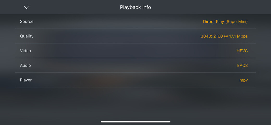

I don’t know what has changed, but since last night, Plex iOS is no longer showing “Multichannel” for any audio codec in the AirPods pull down. It is showing “Stereo” and only giving the option to Spatialize Stereo.
Plex itself is showing direct play, so I don’t know what is going on.
Files with TrueHD audio are also now playing (automatically transcoding to OPUS) and Plex iOS is offering to Spatialize Stereo for this TrueHD media.
