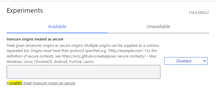

Not really a solution but possible workaround until you can figure it out
chrome://flags/#unsafely-treat-insecure-origin-as-secure
Select the dropdown as “enabled”, and put your server address in

Thanks - I don’t think this will help - I don’t have any problems playing via any of my browsers - they all work fine. Also the android app plays fine when playing back on the phone. The only problem occurs when I try to cast from the app (or chrome browser) to a chromecast device, where it fails with that error.
