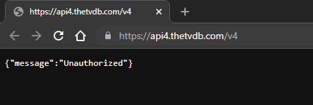

Are you able to reach this url: https://api4.thetvdb.com/v4 ?
It should just return an “Unauthorized” message (that is normal).
yes, it looks good:
