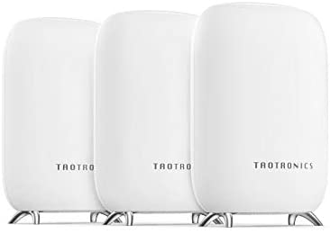

I have just set up a mesh wifi system (TaoTronics Mesh WiFi Router, Tri-Band AC3000). When just using my talktalk router people could conect to my plex server remotely no problem. Now i have the new router they are unable to access my plex library, they get a message saying plex is currently unavailable. Is there something i need to change on plex or my router itself, bit stumped!
I should also add that plex works fine on my home network. The server on my laptop is a wired connection. Plex works on wifi or wired fine.

Not familiar with those models myself… any reference to DHCP / IP reservations / static IP assignments in the documentation of the router?
I did a quick google search. Port forwarding is called “Virtual Server.” DHCP reservations apparently not supported. You might have to manually assign an address to the server.
Amazon listing. Port forwarding mentioned in Customer Questions.
Product Review. Comment sections mentions port forwarding is called virtual server. Also mentions lack of DHCP reservation.
Hello, I just recently got this same Mesh system this week. As others have said, you cannot set a static IP in the router app. So you will have to configure set it on the PC itself. To setup port forwarding, you will need to create a Virtual Server in the app. For the Host select the computer you have Plex installed on. Protocol Type is TCP. Then set all the ports to 32400. It took several attempts to get the app to mark it as valid, but it is working now without issue.
