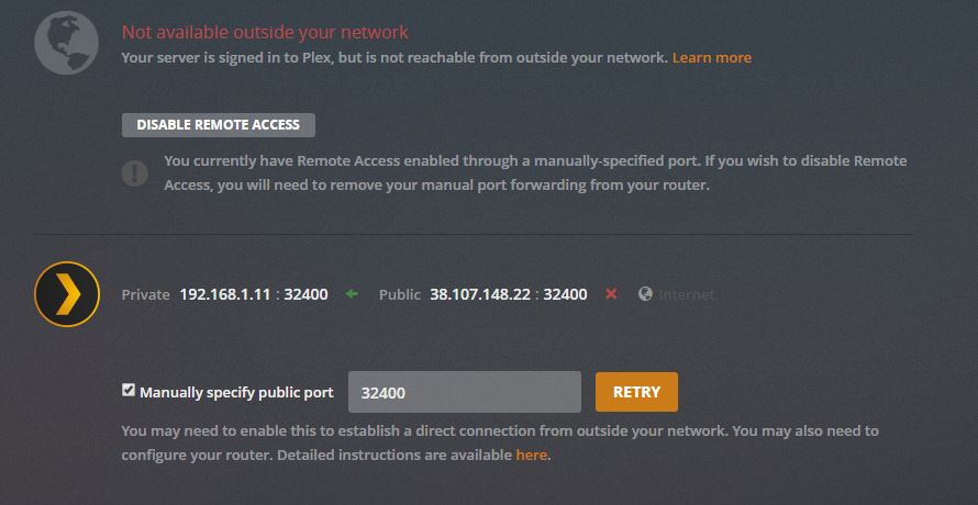

I have a very similar setup to you (version 384.7) and I have the port forwarding set up like this:
It works flawlessly if you manually specify the port in Plex Server.
