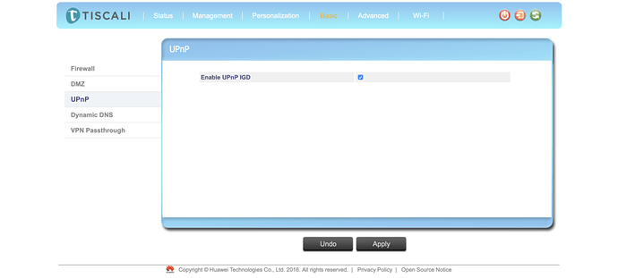

I set port forwarding only on my router and I tried to enable UPnP IGD from the router to see if anything changed. Now on Plex for a second it manages to establish the connection and then it stops immediately (see attached zip file please).

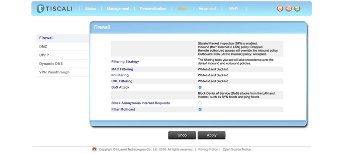

Ok shot in the dark here are you with isp ziggo ?
And if so please check if firewall is enabled and show a screen of the advanced and all the rules if need be via pm. This looks like an issue i have with my modem (ziggo) the new connectbox ■■■■ piece.
If firewall is disabled none of the rules or upnp wil work.

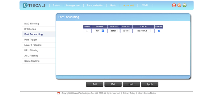

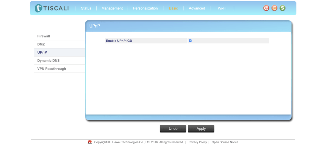

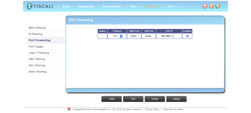

Here are screenshots of my router settings.
Even if I try to disable firewall settings like DoS it won’t work.
I see that that wan port (external) and lan port (internal) are different you only do this when you want to re map a port. (I assume you though it can’t be the same ? )
Zo unless you are doing something special (do tell :slight_smile: )then set both ports to 32400 and tick the manual box in plex and fill in 32400 save and reboot everything.
