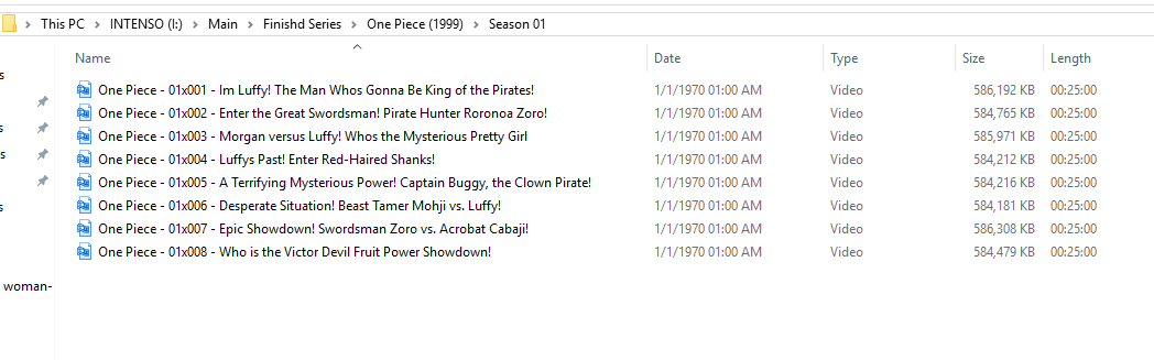

Here is the problem to test if it works perfect for anime i made 4 version of 1 anime show.
This is how the are made in windows:
This is how all maps are setup, and for normal tv series and movie it works on plex with the correct art and info.

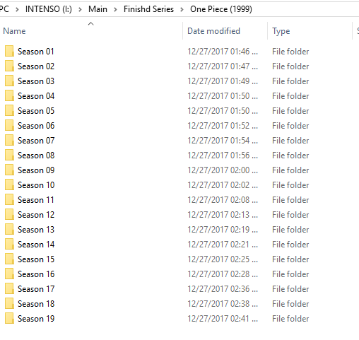

8 seasons in 1 folder and the rest in separate folders

Your titles aren’t named quite correctly. The naming convention says:
TV Show name - s00e00 - episode title
Yours are:
TV Show name - 01x001 - episode title
Please check the naming link in my signature. Take a single season and move the entire directory out of the scanned location and do the Plex Dance.
What I can’t believe is that there are actually people that go around with no file extensions - kinda like walking around town with no pants on. lol

It looks like from your screenshots, you might have the library pointed to the wrong location. Using your screenshots (and this is a guess, based on them) you folder/file structure should be something like this:
Finished Series >>>> Your anime library should point here
… One Piece (1999) >>> The folder containing the seasons and episodes from One Piece.
… … Season 01 >>> The folder holding episodes for season 1
… … … One Piece - S01E01.mp4
… … … One Piece - S01E02.mp4, etc, etc
… … Season 02 >>> The folder holding episodes for season 2
… … … episodes from season 2 like above
… Another anime series >>> The folder containing the seasons and episodes from more series.
… … Follow the same folder and file structure for this series.
I think you are seeing the weird results because of this. You should never point your library to (in this case) “One Piece (1999” It will end up with Plex trying to match to a series called Season 01, Season 02. etc. If you have it pointed to the individual season folders, you’ll likely get even worse results.
If you rename the files as suggested, and get the library aimed to the folder above the Series/Shows folder, things will likely begin to work as you expect. :wink:

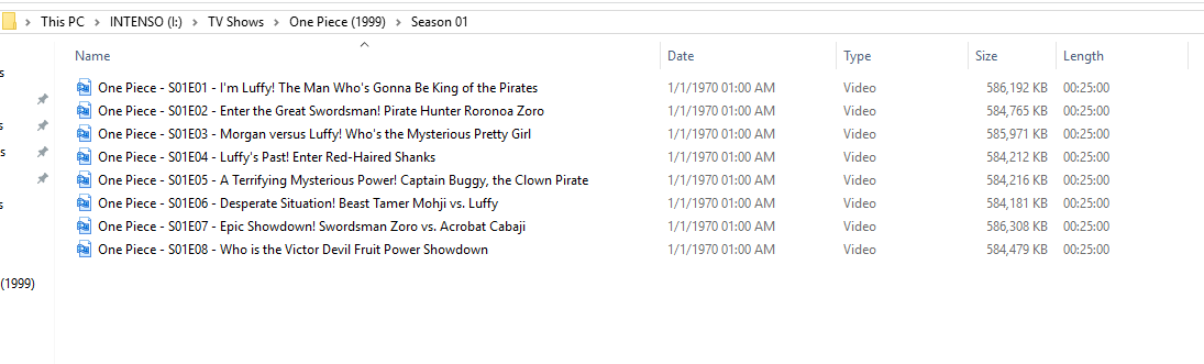

Oke i follewd all your advice.
I did rename ( used filebot + plex automated).
I did the plexdance.
Used tvdb
And this is the result.
