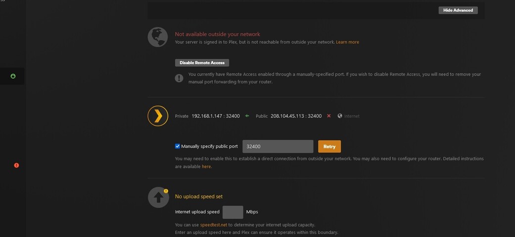

I just had a new pc made for me and during the transition was having problems with my Plex server so i decided to create a new one. I just set it up, invited my brother. And he is able to log in and see my server name, but it always says unavailable as far as my libraries go (I only have one right now). I had some difficulties back with my old system (double nat? i had a static IP for awhile), i was able to run my old server (it would say unavailable outside, but it was available, just everything would be transcoded (not the actual quality), and yet everyone was ok with it.
I have tried with and without my VPN, I have tried with and without a specific manually specified port. One time while testing my brother actually saw my library but no other time. Help would be appreciated…

c:\>nslookup 208.104.45.113
Address:  208.104.45.113
Looks like you’re on a CG-NAT network, which places the server in a double-NAT situation.
Ask your ISP about a public, static IP address.
After months of help here on the forum, and going through my IP I actually resolved the double nat situation and things were great and then my IP basically changed my IP address by mistake and made a mess i never came back from. the last time i was able to set it up and people accessed server even though it said not available outside (and pretty sure i didnt do anything with the router set up), BUT they received everything transcoded, which they were ok with. I would be happy just to get back to there.

Ok problem solved… Turns out even i couldnt watch my server on my tv (i had to re-link it due to the new server). Once i did that i had my brother re-try. If i have my VPN on he cant access my server, once i disable the VPN he could. This wont be an issue as soon ill be doing my downloading (and VPN) on a different PC then my server will be located on. Thx for the Help :slight_smile:
