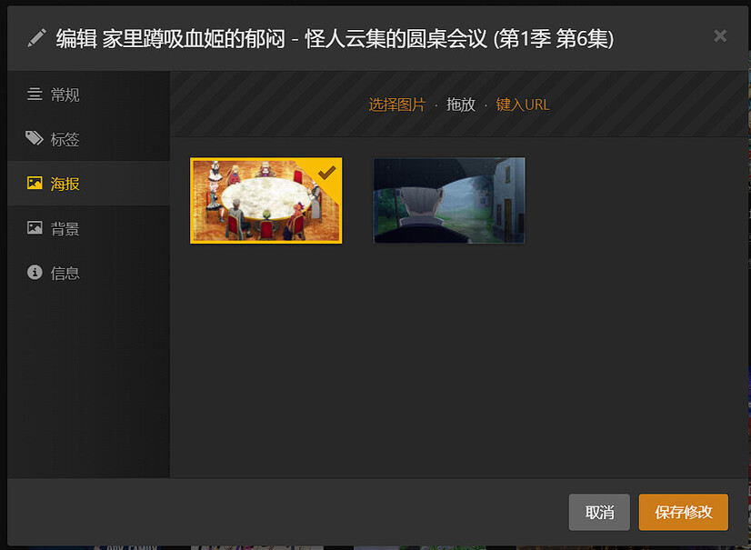

When adding an episode of a TV series to my media library, Plex only fetches a single screenshot out of the several available for that episode.
This limitation is quite inconvenient as it hinders my ability to select and switch between different screenshots in the editing interface, compelling me to add other images manually.

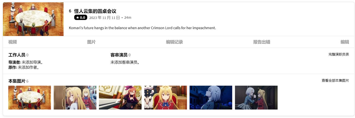

I think the show you are talking about is this one The Vexations of a Shut-In Vampire Princess (TV Series 2023- ) — The Movie Database (TMDB) and if so then looking at the change log for s01e06 https://www.themoviedb.org/tv/217755/season/1/episode/6/changes then I can see thumbnails were uploaded on the 11th Nov, approx 2 days ago.

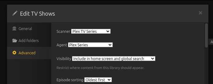

BTW… if your using “Metadata Agent: the movie database” then I’d also suggest you switch to the plex series agent which is the new modern scanner/agent for plex. Any other options are legacy code which plex is no longer updating and not really supporting.
Thank you for the reply.
I tried adding a new library and set the agent to Plex Series, which correctly retrieved all the information including all screenshots.
However, when I tried adding an older episode with the agent set to themoviedb, I encountered the same issue of only the first screenshot being captured. This might indeed be a bug.
